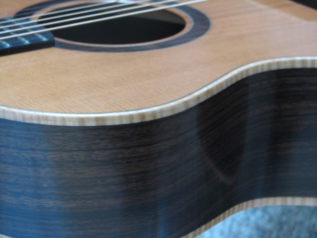

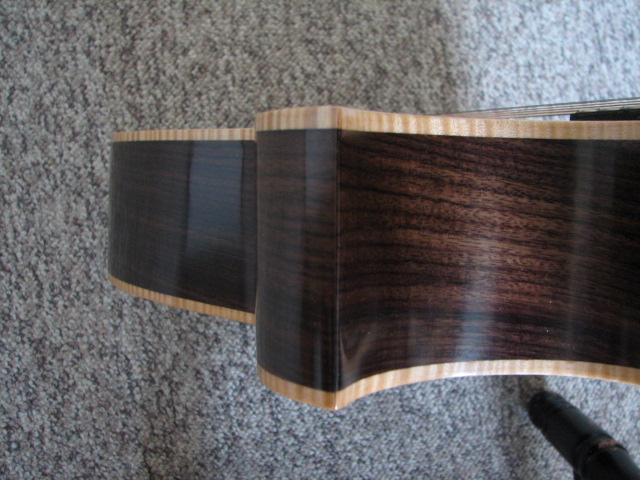

I have not done side purflings before and have used flamed maple on the last few boxes I've done.
Here is a couple of pics

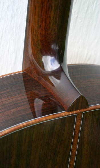

Well this Mr Grumpy does
Rupola lacewood binding on Cuban Mahogany sides:

Personally I think the side perfing adds that extra level of class to a guitar, pushes it over the $2k range.

No I'll let you off on this one Steve, Either look is cool

Dave W.--that's a fine looking guitar! Of course all we can see here is one bit of one side, but I bet you handled the rest with aplomb. Or perhaps with acherry, but I still bet the whole thing looks good.

Do you guys use the 1/16" wide purfling for the sides.
They look narrower in the picture.
